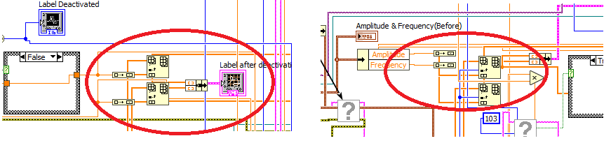

Also, what is this? (just the tip of the iceberg!)
Hidden wires flowing in all directions. Aren't these just Rube Goldberg versions of simple "built arrays"? Why not use a single 1D complex array for the xy graph data?
