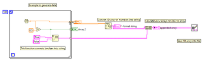

Hi, this is a sample of my code.

So you find duplicate entries in the %Y%m%d_%H%M%S_Versuch.txt file? Your code can be greatly improved, but apart from this, I don't see how duplicates could be generated there. Can you post an example output file?

I don't think someone is willing to help you with code like that:
(navigation window, highlighted area denotes a FullHD screen)
Generic suggestions: Cleanup your code. Use (more) subVIs instead of duplicating stuff. Implement better data handling…
I wonder how your code will run "correctly" at all with (several!) loops running forever stacked inside other loops also set to run forever!

My suggestion is to replace the code where you save the data:
Instead of using individual numeric/Boolean , save them as arrays,
convert them into string and that's it. It may be very difficult to debug that part of the code, easy to make mistakes.
