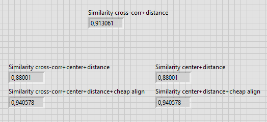

@altenbach wrote:
@alexderjuengere wrote:
Interesting idea to do a cross-correlation with the derived 1d arrays!
Of course you could map the data into 2D arrays and do a 2D cross correlation directly. 😉
wait a second, I think I have re-invented the wheel ...
if this is the formula for cross-correlation,
the numerator is the product of centered x and centered y, and the denominator is the product of the distances,
but not with regard to 0;0
bur rather to the mean of the template 336;170
dammit.
at least I learned something new.
@ Kahr
good luck in making this quick enough
I think, this is possible, and LabView is capable of doing this
but you will have some work to do...
Message 16 of 16
