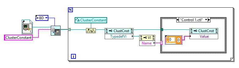

VI Scripting is probably your best bet here. You can create a script which traverse your VIs looking for the typedef, then update the value with a new default value. Here's a quick and dirty example:
Edit: VI Scripting is enabled under Tools -> Options -> VI Server -> Show VI Scripting functions and methods
