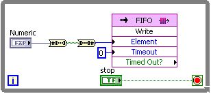

You've been very helpful throughout this project I've been working on.  The document wasn't exactly an answer, but it did point me in the right direction.  I've decided to change my fixed point representation down to 32,16 since the 64 bit representation seemed like overkill.  I hadn't thought of using the number to boolean array function, which apparently does work on fixed point numbers (I got that idea from the document, even though the document didn't use the FXP type explicitly).
Converting FXP 32,16 directly to and from U32 resulted in some ugly data loss, but changing the FXP to a boolean array, and then to a U32 worked perfectly.  (Hint - this conversion would be super helpful in the "To U32" function if it's feasible)  I've attached a picture, since it pretty much clears up the methodology.  If anyone ever has to encode a 64 bit FXP number into U32 numbers, there has to be a way, but I think I'll save that one for another time.

I did update the KB yesterday and it should be back on the web soon, but for quick reference here are the changes that were made.  The important part is that the conversion VIs in the KB are not needed, since all you need to do is right click on the boolean array to number and select it's properties, then change the output type to fixed point along with the settings for the fixed point number.  Let me know if you have any questions on this.
As of LabVIEW 8.5, the DMA FIFO only supports the unsigned 32-bit data type.  If the fixed-point number is passed directly to the FIFO, the fractional portion will be truncated when the number is coerced to an unsigned integer. In order to preserve the fractional part of the data, type cast the fixed-point number as an unsigned 32-bit integer that can be written to the DMA.
To do this, you will need to pass the binary representation of the fixed-point number over the DMA FIFO and convert this set of bits on the host.  The steps below detail the method to pass a fixed-point number to the host using a DMA FIFO.
FPGA Conversion
  1. Convert the fixed-point number to an array of booleans using the Number to Boolean Array VI.
  2. Convert this array of booleans to a numeric using the Boolean Array to Numeric VI.
  3. Wire the output of the Boolean Array to Numeric to the Element input of the FIFO Write VI.
Host Conversion
  1. On the host side, read a number of elements from the DMA FIFO.
  2. Convert each element one at a time to an array of booleans using the Numeric to Boolean Array VI, inside of an auto-indexed for loop.
  3. Place a Boolean Array to Numeric VI inside of the for loop and wire the boolean array to the input.
  4. Right click on the Boolean Array to Numeric VI and select Properties.  Change the representation to fixed-point and fill in the Fixed-Point Configuration according to the properties of the fixed point data type on the FPGA.
  5. Wire the fixed point data type out of the for loop into an auto-indexed terminal.
Note: It is required to know the settings of the fixed-point data on the
FPGA in order to convert the number on the host.
Once the fixed point data is converted, you can use the numeric conversion VIs to convert the data to any representation that is needed on the host.
Note: It is necessary to use the Binary Array to Number and override the output type under the properties of the VI.  Using just the Binary Array to Number and then the To FXP VIs will also truncate the fractional part of the data.
