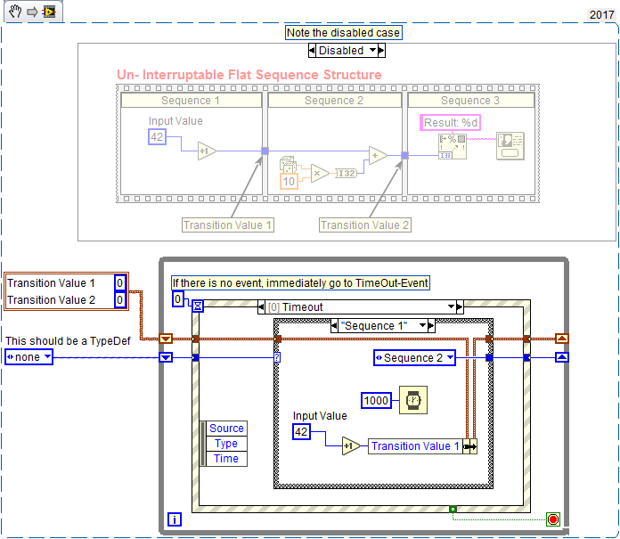

As a start, I made a little example of a conversion from a flat sequence to a state machine.
Greets, Dave

Accepted by topic author zahidkjatoi
Using the example already posted as an idea - there is no reason the states have to be linked. Attached is a VI with 3 steps all just performing addition with no communication between states, using a 0ms timeout event structure.
