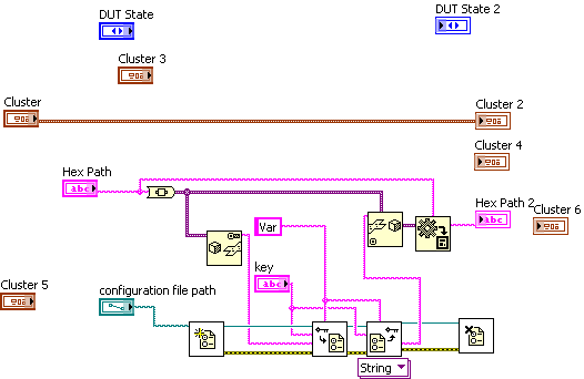

Here is a case where I use the varient functions.  In a nutshell I have a Test Exec machine that enqueues vectors read from a ini (sample attached).  The queue contains a state that will run, the vector to test, and a varient of all data necessary for the exact state that will execute in the cunsumer loop.
The attache picture will give you an idea on how I read and write the state specific data to the device specific ini file.
Of certainty, I have masked some of the information as the project is propriatary but, it could serve as an example of when the feature is desirable.
In my test applications there a 4 major modules and three queues.  The modules are UI, the Test Executive, the Test state, and the Display and all flow control is driven via the TEqueue, TSqueue, Dqueue and UI events.  By using the varient data type I can re-use all of the test mainline and only need to edit the test state cases and some cosmetics on the Main GUI- 90% or more re-use.
