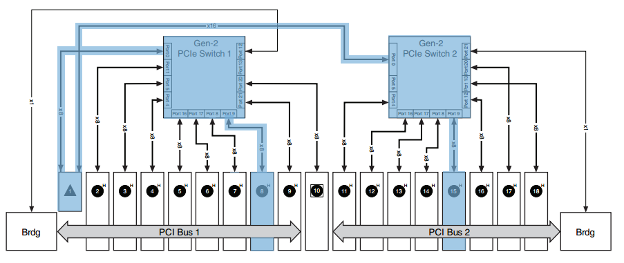

Out of curiosity, what slots are you using for the 7976Rs? I'm curious if they are on the same backplane switch or if it is routing through the MXI chipset.
I'd take a look at the user manual for your chassis and if they are not on the same switch, switch slots so that they are, then give that a try.
For example, this is the ideal setup in a PXIe-1085,
and this is the data path if the FPGA modules are on different switches.
Rob B

I am using slots 2 and 3 of the 1085 Gen 2 Chassis, so this means they're both going into switch 1 I believe.
I too was curious of this being the culprit, but the switching seems like it should work...
Furthermore, upon looking at the errors in the .h file, I think I'd of gotten one relevant to that error if so.
You'd know better than me though!
