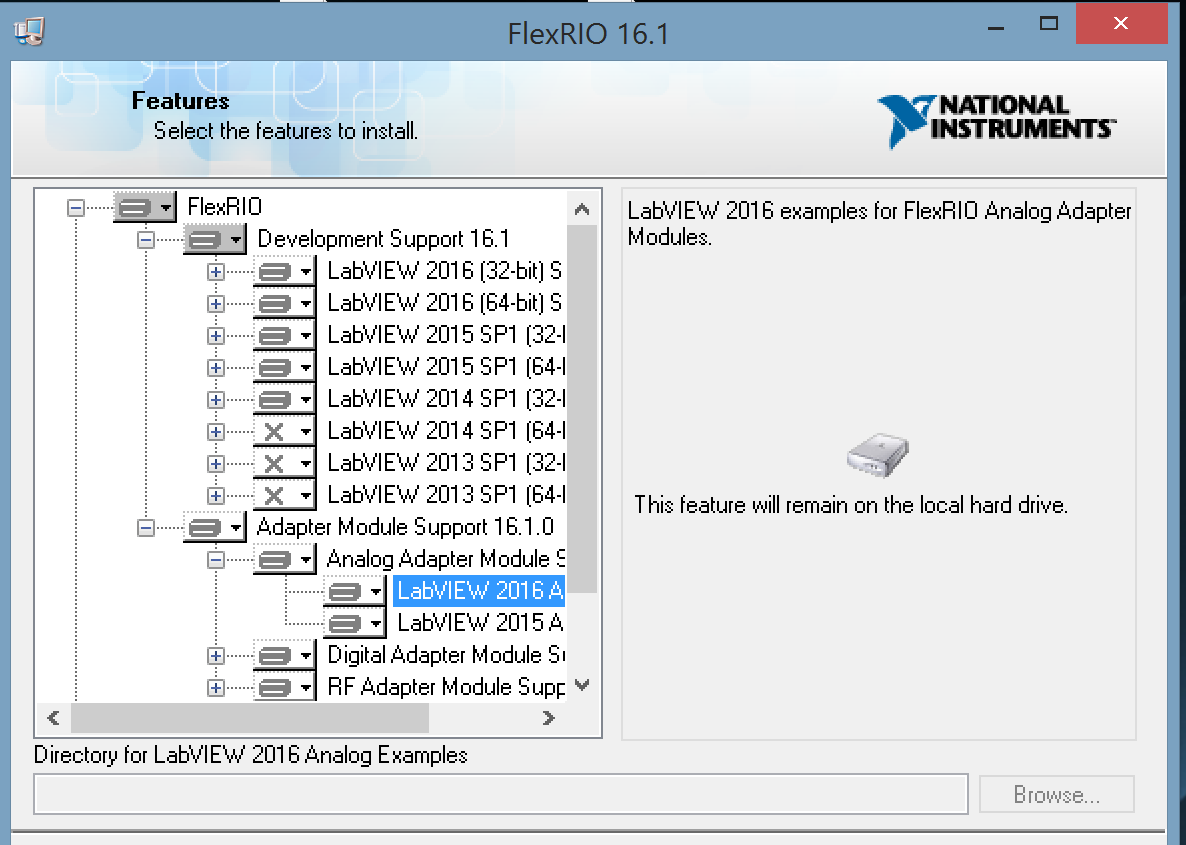

The FlexRIO 16.1 installer shows that there is 2014 support (just not for the examples).  Am I missing something here?
I am using a 5751 FAM and 7965 FlexRIO

I installed FlexRIO 14.5 and now I have those functions in LabVIEW 2014.
