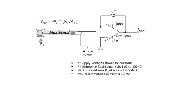

I'm working on a student project and we need to measure the load output of a flexiforce sensor. I have a decent amount of experience with labview, wheatstone bridges, and strain gauges, but none with op amps and force sensors. LabView just recommends using theur DAQAssist module but I have a feeling it won't just go as smoothly.
Do we need to have a similar wheatstone bridge and bridge balancing system that you need for strain gauges? Or can I simply use the single channel DAQ assist that LabView recommends? I've also heard various things about modeling opamps in LabView, is this reliable and accurate?
Here is the basic circuit the force sensor company recommends.
Even any help pointing me in the right direction is greatly appreciated.

Build the board per the vendor's recommendation or buy their Quick start Board to convert the sensor to a voltage reading. This is the signal conditioning that you need. All of the comments about rosette and 16 bit versus 24 appear to be just noise.

Dennis_Knutson thank you,
so this circuit they recommend is the signal conditioning. So this combined with a fairly simple VI and the DAQ will allow me to do what I need?
Message 8 of 18
(9,350 Views)

Accepted by topic author mecheng16
mecheng16,
Yes, the signal conditioning they provide will convert the change in resistance of the sensor to a voltage that can be read by the DAQ card.
