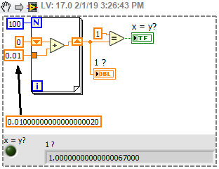

But you are talking about entering the value by typing it in.
But what if you start at another number such as 0 and click up or down 100 times?  100 x an inexact .01 will leave you with an inexact 1.00
Think about 1/3 x 3 in decimal systems.   1 divided by 3 is .333333 to however much precision you want.  Add .3333333, you get .6666666.  Add another .3333333 and you get .999999999, but you are expecting it to be back at 1.00000000.  1 divided by 3 times 3 is not the same as 1.
Run this code and you will see that 1 is not exactly 1 once you are done the math within an inexact .01.

Try showing about 25 digits in the digital indicator.
Drop an "epsilon" constant from the numeric >>> Constants palette and show 25 digits on it.
I THINK the "increment" button is summing the increment (that is a value that can not be represented in binary) and that is where the rounding get in the way.

I agree with everything you are saying about using the "increment" button.
Interestingly, I never tested or even touched the increment button until your suggestion, because this question is about coercing a value, not creating it.
So I just tried it.
As you and I both expected, starting at zero and clicking "down" 100 times gave an "incorrect" result.
