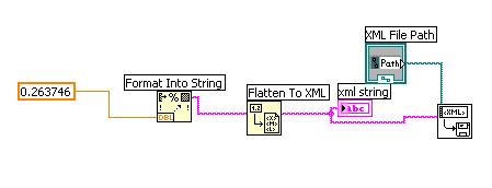

If your output is a number then use a "format into string"
20343i481701FC89EA1E7C
Message 4 of 8
(4,812 Views)

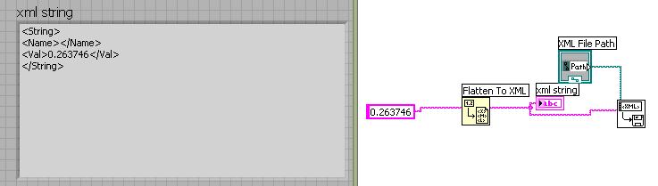

Simple define like this
20349iE2EDD84AB137D272
Message 6 of 8
(4,804 Views)
I tested it and could not see your problem in Labview 2009. So it is perhaps a bug in your Labview version. You can use this VI as a workaround.
