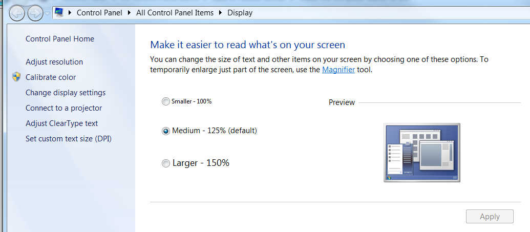

Possibly Font Size.  There is a setting for Normal Size and Large Size fonts.  Or it might be a percentage of normal such as 125%
Message 6 of 16
(4,847 Views)
I think it might have something to do with the Display Scaling?

    So I did some testing.  Yes, the Windows font size adjustment does play into this.  But although some parts of this are getting clearer, other parts get more mysterious.  This is all on W7.  Here's what I found:
   With LV 2014, with no specific custom font settings in LV (searching for "font" in the .ini finds nothing), LV uses 13 when the Windows setting is 100% (small) and 17 pt when it is Medium (125%).  Kind of makes sense.  Didn't try Large.
