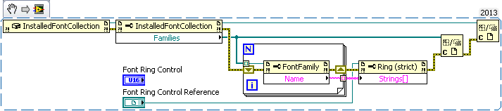

I tried unsuccessfully to use the .NET Font dialog (as suggested here). The Font dialog did not open in front of the calling VI, and I was unable to get a reference to the window with calls to the user32.dll FindWindow and FindWindowEx methods presumably because it is not listed in the taskbar.
Instead, I used a .NET constructor node linked to System.Drawing, System.Drawing.Text, InstalledFontCollection. You can pull out the Families property and read each property's Name. This gives you an alphabetized list of all fonts installed on the system. Shove that into a ring control to give your users an easy way to select a font. See the snippet below. You could also get fancy and search for a particular default font and select it if it's found.
