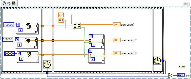

Ah, right. I misread it like he wanted the same limits for all arrays, and coercing 3 arrays of 100k elements took me 6ms.
Here's an alternative that takes me 5ms.
/Yamaeda

Here's what I had in mind. Modify as needed. See if it is any faster. 😄

Impressive, i didn't think it'd differ that much, ~20ms to 4,5. By separating your loop to 3 i shaved off yet some to ~3,5ms.
