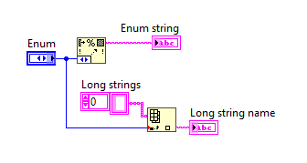

You can always get the strings from the value, e.g. as follows.
You can even do short strings for the enum and a matching array of longer strings to index into (or vice versa).

Sorry guys... I considered adding a more embellsihed disclaimer to point out that I know I can use enums or regular ring controls and access their string value etc, working around the issue, as you describe,..but the issue at hand is if the control *has* to be a string. 😮
