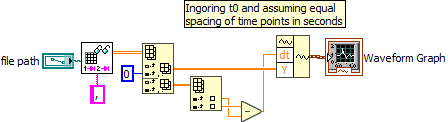

  • What's the purpose of the while loop? Why would you need to read and process the same file over and over, as fast as the hardware allows?
  • You are not making any waveform anywhere. You are creating dynamic data where each row is a channel. The time is NOT a data channel. You have many rows, but only two columns. At least transpose when reading.
  • To create a waveform, you MUST assume that the timepoints are spaced equally, then form a waveform using t0, dt, and the Y data. Is there a reason t0 is 420000? What are the units? The value of dt seems to be 1
  • Why are you multiplying the time also by 0.1? Does that make any sense?
Overall, there are glaring logical flaws everywhere. You need to figure out what you really want.
(Sorry, no drivers installed, so I cannot look at the configuration of your express VI)
Here's how you would create a waveform from the two columns. (I left out the multiplication by 0.1 for the data for simplicity)
Message 9 of 9
