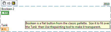

Yes you can put a button over another indicator
