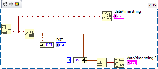

It's caused by the Daylight Saving Time. You can turn it on/off as in this snippet (maybe there's a better way)
Ben64

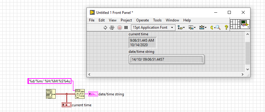

Your conversion from timestamp to string is missing the year.
So it probably isn't calculating DST because without the year, it won't know if a specific month and day would be a part of daylight savings time or not.
Message 4 of 12

Check the Time Zone settings as this works fine for me...
=== Engineer Ambiguously ===
