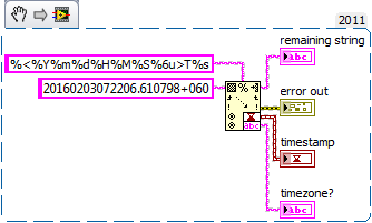

Format LastBootUpTime
Hii,
I have to Wait atleast 15 mins after the PC Boots  and then start with  the test.
with the  "/r wmic os get lastbootuptime"  command line Argument  I do get the   Result [String]
LastBootUpTime
20160203072206.610798+060
but the formatting is the Issue
Is there any elegant way to  get the same in a  Numeric format   else I have to Parse the result   or Script  better...

Hi aparab,
try this:
