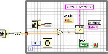

What result are you looking for?  The difference between now and 5 seconds from now is 5 seconds.  That is 0 years, 0 months, 0 days ..... 0 minutes, 5 seconds.  The start of Labview time is 1/1/1904 and I believe midnight UTC.  So formatting a time differential into a date is kind of  meaningless.  If you do subtraction of the time clusters like you do in screenshot #2, then you would wind up with negative parts of time.  You'd have to resolve it back to time stamps.  Note that the earlier version of labview had a lot of bugs converting unusual time clusters to valid timestamps.  And even LV 8.5 still has one error in that function.  For example, month 3 day 33 is not a logical date, but without the bug it resolves to April 2.  Great.  With the bug, it gives an invalid time stamp.
Why not do the subtraction on the time stamps, and use the Format Date/String function on the timing palette and format the string the way you want to?

You can just use a numeric or timestamp control, but change its format to relative time instead of absolute time. You can even select the advanced mode and change a lot of things in the formatting.

To clarify - use the first example you posted and create an indicator immediately after the subtraction. Then, right click it, select Properties, go to the format page and select relative time.
