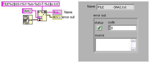

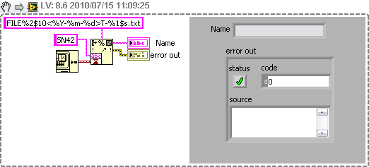

Formatting a timestamp into string with $ specifier does not work; the formatted string is empty and no error is reported:
19061iB67D59F74C86F953
I have forced the width to 10 to show that the format is at least partially scanned but when it is omitted the timestamp field is empty.
I couldn't find this problem reported/addressed so here it is (LabVIEW 8.6)

Also, I forgot to say that I can confirm this in 2009.

Ok looking at the format string, the expected output of the code would be "FILE2014-09-19-SN42.txt"
Instead we get "FILE          -SN42.txt"
