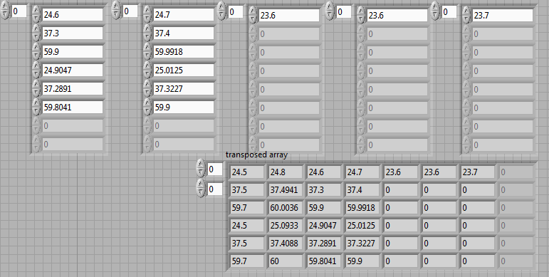

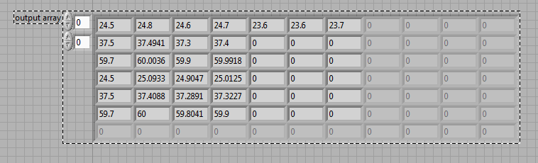

or if array sie is not the same .... (the last 3)...then delete those columns?

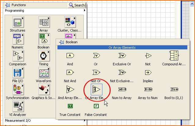

what is the upside down E function?
i cant find it.
Message 3 of 18
(6,173 Views)
look in the boolean palette. 😉 (...and it is not upside down, but mirrored)

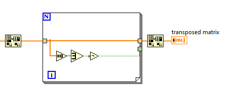

Message 5 of 18
(6,156 Views)
i did the same block diagram as the image posted but i have the same results?
where is the true/false wire going to?

Message 7 of 18
(6,129 Views)
i didnt know where it was going so i just placed it next to the outter border of the for loop.

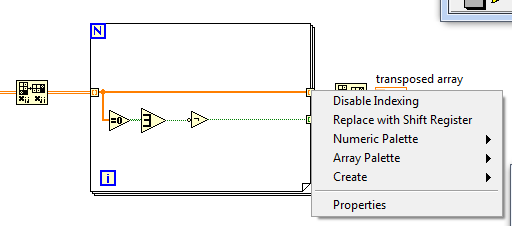

You need to right-click the orange tunnel to the right and select "tunnel mode: conditional". That conditional terminal is part of the orange tunnel.
(If you have an older LabVIEW version, you might not have that option).
