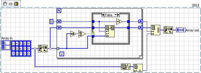

Here are two possibilities. The second version has a little more code but is more efficient, especially if the arrays are large.
Message 12 of 18
(3,330 Views)
Accepted by topic author super_saiyans

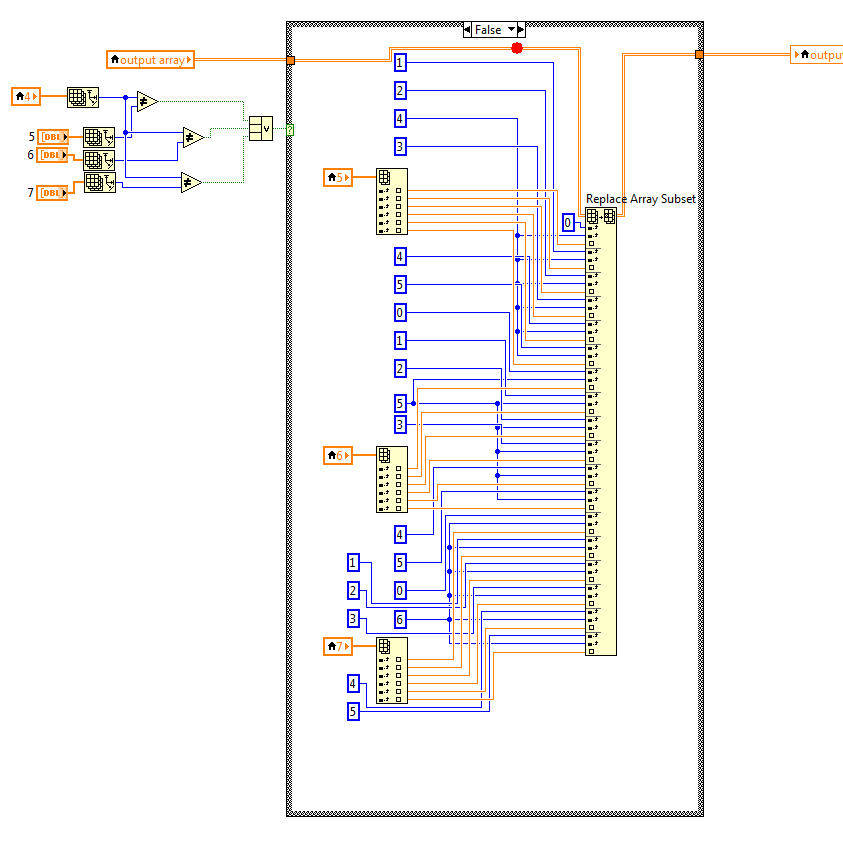

haha. both of you guys are fast!
sigh..
i created this!!
which is a mess!!
saying that if arrays are not the same size..delete or dont insert the array into another array..
if its the same size..then continue adding into array..
yeah..i got a lot to learn!

I wonder if you are trying to make a non-rectangular array? You are aware that it is not possible to have a 2D array in LabVIEW with rows having different lengths? That is not possible in LV, although you can "fake" it with an array of cluster of array.
sigh..
i created this!!
which is a mess!!
There are many things wrong with this:
  • Why do you have these local variables (4,5,6,7, etc)? Just use a wire. I assume that the arrays don't change during the execution of the loop, right? Why do you think you need to re-read the control (or local variable) with every iteration?
  • You can replace entire array subsets, no need to index out element by element.
  • output array belongs in a shift register, no local variable needed.
  • There are easier ways to tell if four values are equal. 😉 Where are these arrays coming from? Don't you also need to compare with the size of the 2D output array?
