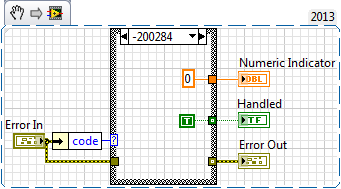

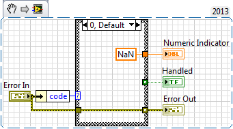

Since you know error -200284 means signal not present IN THIS CASE. handle the error!  If error in  -200284 then error out =F and set freq to 0
