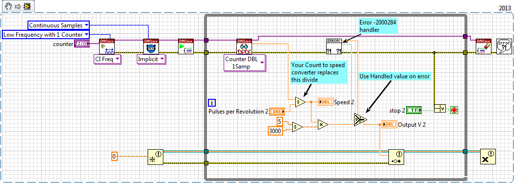

Thanks for your answer. I think I understand what you mean now.
From the diapgram you drew when the VI is in error the handled output becomes True and the Numeric Indicator becomes 0 and the error output is cleared. I guess I need one of these routines per frequency channel. Also where do you recomend connecting the Handled and Numeric outputs within the VI.

@r.youden wrote:
Hi Jeff,
I massively appreciate your help.
About like this....

That's great thanks Jeff.
How would I create the Error handler? I guess that contains the case structure you showed earlier and that is made into the block... How would I go about that?

the same way I remade it.   FROM the snipette.
Drag the picture to your desktop, drag it to a blank BD POOF!
(Kudos to anyone who can find the link to where I "Jinged" that in the last 2-4 months)
Add a icon and connect the terminals to the con pane
