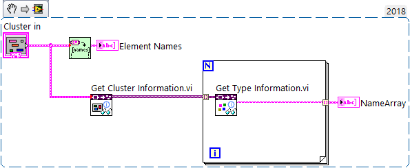

In your consumer loop, you are checking the status of a a queue. If no elements in the queue, then you have a wait function. Just dequeue the data as it comes in, have no timeout, much simpler.
You are using the OpenG data type parsing VIs; not sure when the change occurred but newer versions of LabVIEW have explicit support for data type parsing, much faster than the OpenG methods. See snippet below.

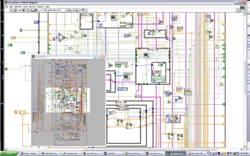

This is why we can't have nice things, this is why LabVIEW gets a bad wrap for not being a proper programming language. This is why newbies want more 'Control and Indicator' References. This is how to properly implement Local and Global variables in LabIEW. This is why you need dual wide-screen monitors to program effectively in LabVIEW. This is why you need a ball-mouse.
Message 16 of 16
