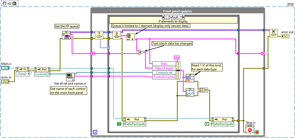

I am looking for a better architecture to update the front panel of the program I inherited.
There are 200 graphs, indicators and controls. I am trying to centralise all the proprieties and value changes in one VI (let's call it FPUpdate.vi). The goal is to improve the maintainability and being able to add controls easily in the future. Also I believe it is a good idea to update the controls and indicators all at once.

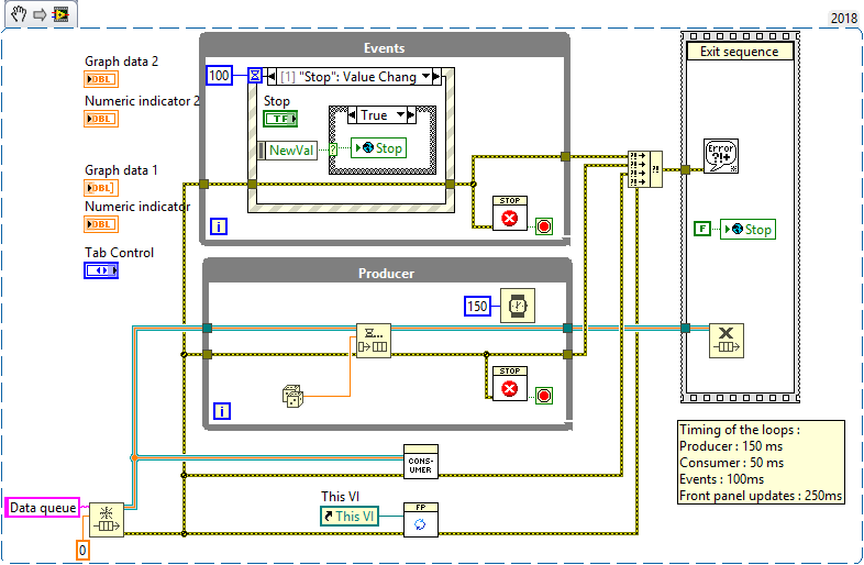

I started a new project to make some tests, here is what I tried so far. The consumer loop put the data in a queue and FPUpdate.vi dequeue and change the values of the indicators. This way, only FPUpdate.vi needs to have the references to the FP.
The data queue contains a cluster of all the data displayed. The user does not need to see all the values, only the newest are interesting. That is why the data queue is limited to 1 element.
This simple program works but there is only one place where I enqueue the data. The real program must be able to change the values from multiple places and I didn't find an easy way to avoid race conditions with this architecture.
Another idea would be to write the data in a global variable and FPUpdate.vi would read this variable periodically to update all the indicators.
Do you have any advice ? You probably even have a better way of doing things ?

Please open "FP architecture.lvproj" then main.vi. I included OpenG Vi's in the zip file.
Snippet Main.vi
Snippet FP update.vi

Don't have 7z, but here are some comments from the snippets posted.
The queue in the snippet is not limited to 1 element; my suggestion is to explicitly wire the number of elements terminal to 1 and always use a lossy queue insert, that way you always have the latest value.
Queue can have multiple producers and a single consumer, that is, many to one. You will always have the latest value with this method, unless, your clustersaurous has muliple elements updated in different parts of your program.

Just guessing, it looks like you are updating the front panel using the value property and a control reference, never a good idea. Why like make a loop in your main program where you dequeue your queue and update the indicators directly?

The main VI currently uses a lot (600) of propriety nodes and local variables. I am trying to reduce this number but I don't have time to re-write everything to only use the terminals (at least I don't know how to do it quickly). The main VI is enormous and I can't create sub-vi's because of the propriety nodes. My plan was to replace the propriety nodes and write in queues the data and proprieties. Then only one VI would handle the updates with propriety nodes.
Another reason I did not suggest the use of terminals is to reduce the size of the main vi (200 controls).
I am also considering sub-panels but I never used them in a large project and I don't know how easy it would be to implement in this program.
