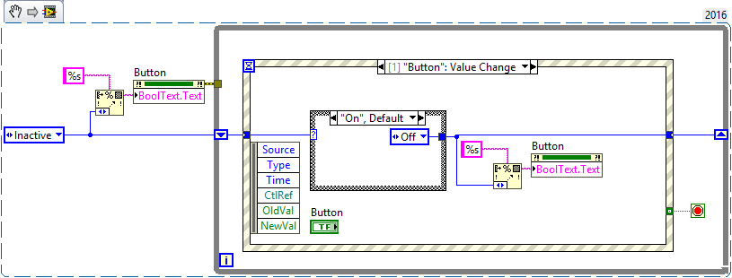

You can use an enum, or a ring, or a combo box, or one of the attached controls.
