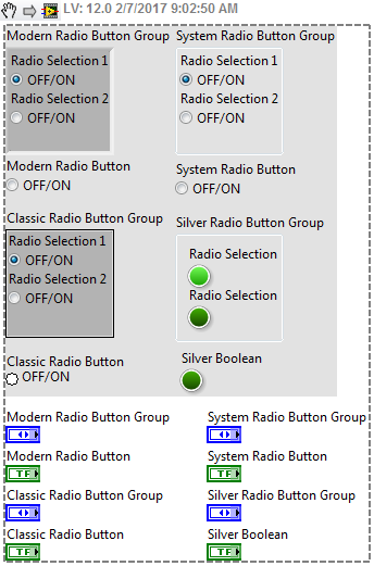

I've used a radio control with 'tailored' controls for just that purpose.  It is NOT a tristate LED but I think it's better.  A tristate LED used as a control to select On, Off and Don't care (as you indicated) would not be intuitive to the user. I like my solution much better - but I'm a little biased 🙂
I'm not sure why the Radio Button didn't make it into the Silver palette. You can find Radio Button controls on the Modern, Classic and System palette under Boolean controls.  The Modern and System radio button are , "misplaced" in that their types are uInt32 however not boolean. The Modern and System radio buttons have an advantage over the Classic radio button in that you can add as many 'radio  knobs' as you like. The greatest advantage, one which I've leveraged, is that you can replace the control to whatever you like. You can even mix them! For my solution I dropped a radio button from the Modern palette, right clicked on the radio knobs and replaced with square buttons. I then set the colors in such a way to illustrate On (bright green), Off (dark green), and Don't Care (dark grey).  This, with proper labels, clearly indicates to the user the usage of the control and the chosen state.

There is nothing misplaced about the Modern and System radio buttons datatype.  A single radio button, by itself, does have a boolean datatype.  If you are looking at the radio buttons group, which has more than one radio button, this datatype cannot be represented by a 0 or 1 alone so, yes, it does have a uInt datatype.
Edit: I now see what you mean by misplaced, being in the boolean pallete rather than the numeric pallete.
What would you want the Silver radio button to look like?  You can make one by replacing the radio buttons in any of the other versions with Silver LEDs.
