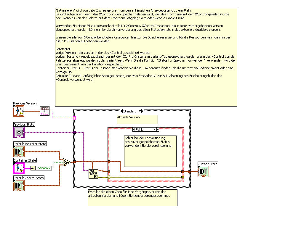

2) Here is my init vi:
As you can see, this is still default. I have not changed a thing. Maybe I should?
3) This could be the case! How can I prevent this, if it is the case? Other XControls work fine. I will try a minimal experiment.

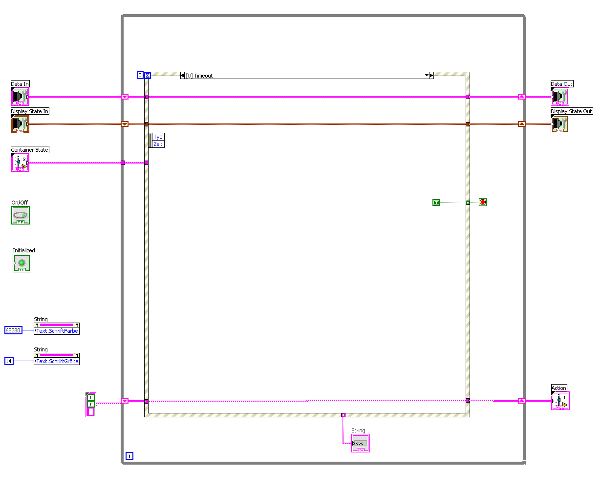

To Altenbach: I tried to follow the instructions. Heres my facade timeout. Maybe the need to be more in there:Camera_Configuration_Facade_Timeout.png
