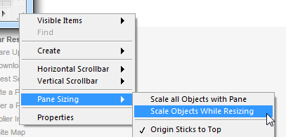

Right click on the pane (right click in the bottom right hand corner) and select the 'Scale objects while resizing' option.
That should fix it for you 🙂

Thanks, but I didn't see improvement. What exactly does that property, I culdn't find in property nodes..
It seems that unchcking Lock Panel in event structure made it.

It should be more or less obvious what that setting does when it is used.  If you set a control to fit to the pane, and then resize that pane, it doesn't wait for the mouse up to start the resize, it will resize it for every pixel movement of the mouse.
