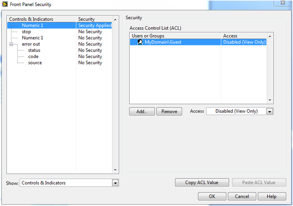

I search web and this forum without success. Where is Front Panel Security in labview 2014. On web for LabView 2011 . Tools-->Security--> Front Panel Security.
I want to disable change some variable for some user. I create user...but not have this option about FrontPanelSecurity.
Can you help me ...where  I can find this Panel on labview 2014?

Yes ..i want prevent changing the value  for some users. I create "administrators" and "operator user."
I want this:
Administrator can changing value of the variable and controls.
User can't changing value and controls.
Disable or lock variable and control not resolve my problem. How I can make this on LabView 2014:
https://www.ni.com/en/support/security/enhanced-system-security-with-the-labview-datalogging-and-sup...

The link you posted is for DSC. You would need to purchase this and license it for LabVIEW as it is an add-on.
https://www.ni.com/en-us/shop/product/labview-datalogging-and-supervisory-control-module.html
Message 6 of 9
(4,874 Views)
I had never seen this option, mostly because I don't use the DSC (DataLogging and Supervisory Control) Module.  Once I installed it, a new Security Menu item appeared on the Tools Menu, Front Panel Security appeared in LabVIEW Help, and I could see a screen similar to the one you show.  Incidentally, searching for Front Panel Security in LabVIEW Help, even without the DSC installed, gives you Help that says "Requires DSC Module".

Thanks to answer.
After  buy and install DCS module...i have this option.
Regards.
