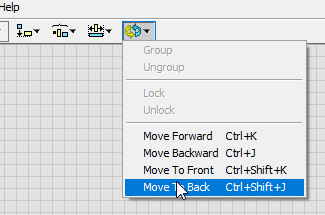

In fact what I want to do is put an image on my front panel and put indicators/controls on it to make a user interface.
The problem is that I have copied and pasted my image and it is on my front panel but the indicators/controls are below it except that I want them to be above the image.
Change the Z order of all those frontpanel items!
There's a button in the frontpanel window menu bar to do so…
(2,878 Views)
Select your picture, after that:
Second option:

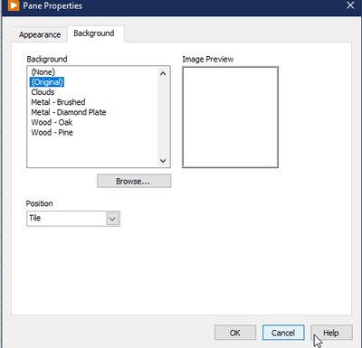

This can also be done manually, right click on scroll-bar of the frontpanel, select properties:
Now edit the background properties of the pane:
