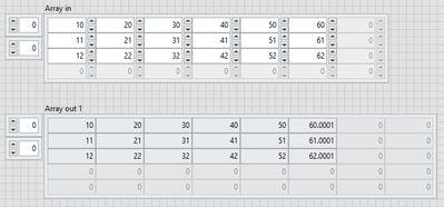

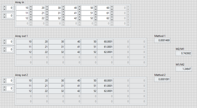

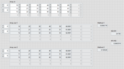

I made a quick array modification SubVI to modify the last column.
Secondly, why not optimize this code slightly? And what is optimization without a benchmark?
Task, multiply last column with 1.000001. Do this 1 000 000 times.
Method 1: use array functions. Method 2: use in place array functions
So in my head "Method 2" should be the best one in most if not all input examples.
What "Method 1" 25 times quicker?
Hmmm, I remind myself again I need to stop doing this small optimizing tasks πŸ˜„
Optimizing before finding something that actually matters to optimize, is not the way to go if you want to get more done.
So, then at last, what is optimizing without turning off debugging?
Wow, in-place method won!!!!!!! πŸ˜…

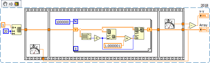

What about a 3rd method? Just Index out the last last column, mulitply and Replace Array?

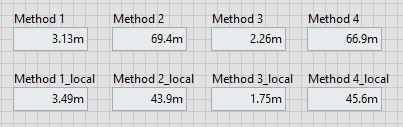

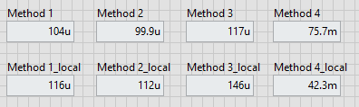

Ok, had to add it to the test, Method 3. Slightly modified to compare similar code.
With debugging on this Method 3 is the winner.
But turning debugging off, Method 2 still wins:
Thanks πŸ™‚

So with debugging on:
And debugging off:
Crazy how Method 4 costs like 400 times more than method 2.

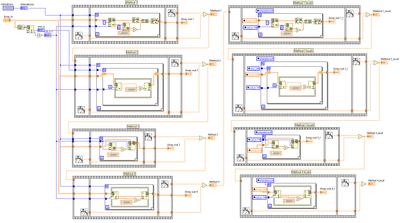

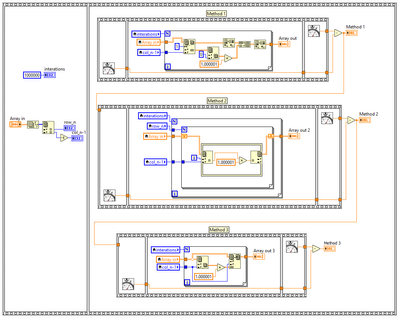

First, thank you for your feedback!
Ok, I must be blind or something. I can't see what you see πŸ™‚
Could you share your .vi? I don't understand how you managed to get your results.
GerdW: All methods are performing the same task right? Do you agree? Anyway, I just had to test it πŸ™‚
FYI: doing the same task 1 000 000 times is just to get a more measurable benchmark on a function like this.
So to challenge your statements I modified the benchmark to run methods 1 to 4 without reading and writing to inside the benchmark, but also added a copy where locals are used and writing to the indicator is included. First, as this read/write is only done once during the benchmark, it does not matter too much. Secondly, it shows that it does not change the ranking between the methods (but debugging on/off changes ranking).
Debugging on:
Debugging off:
Picture of the benchmark code:
