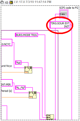

Possible error in your commands?
I see one says "TIRG:SOUR EXT INIT"  I would think that would be "TRIG: ....."

Did you mean I should use "TRIG: SOUR EXT INIT" instead of "TRIG: SOUR IMM"?
But I don't use external trigger source... I use the internal trigger.

Oh I see what you mean. But I don't have commands saying "TIRG: SOUR EXT INIT" in the attached .vi, do I?

Yes, you do.
