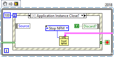

There are two questions here -- one is how to properly handle the "Application Close?" X in the upper right corner of your Main VI, and the second is how to arrange all of your VIs such that the Main can tell all of the others to stop.
If you stop your Main by pushing a Stop Button on your Front Panel, which cause the Main routine to go into its "Shutdown and stop" routine, it should reach out to all the other VIs and tell them to stop.  So how to handle the Big Red X?
Create a User Event and have it handle the event Application Instant Close? (which is an Application Event).  This "fires" when you push the X.  You want to wire "True" to the "Discard?" terminal because you do not want Windows to close your routine, you want LabVIEW to do it.  So do whatever you would ordinarily do by pushing a Stop button and having an Event catch that action and start the Shutdown.  Here's an example from one of my routines (I'm using a Message Handler, and I'm sending the "Stop" message to the Message Handler Loop, which tells everyone else to quit).Application Instance Close? EventApplication Instance Close? Event

I would recommend using the Panel Close? event instead. The Application Close? Event should fire in an EXE, but not in the development environment (IDE).

I had been testing this in the development environment and was pulling my hair out not getting this to work with the "Application Close?" event rather than the "Panel Close?". It is behaving how I expect it to now.
Thank you both for the help.
It works equally well in Development and Execution Environments.  I learned this Piece of Wisdom from a "Fab"ulous LabVIEW Champion (whose name I am conveniently forgetting).  She (hint!) gave a wonderful presentation at NIWeek 4-5 years ago that had many words of wisdom, including the Wisdom of Always Using a Time Machine (a.k.a. Version Control Software).   But I knew that ...
