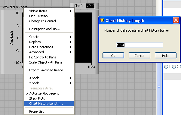

I am using a waveform chart and I am trying to set the maximum value in  x axis scale equal to 3000. However, after closing the properties window the value returns to 1023 (the auto scale is not selected). Is it something that I can do?

Right-click on the chart and select "Chart History Length..." at the bottom of the selections.  Change it to 3000.

The chart history is set to 1024 points by default.  So you'll need to change the history to 3001 points to display 3000 on the x-axis scale.
See image below:
