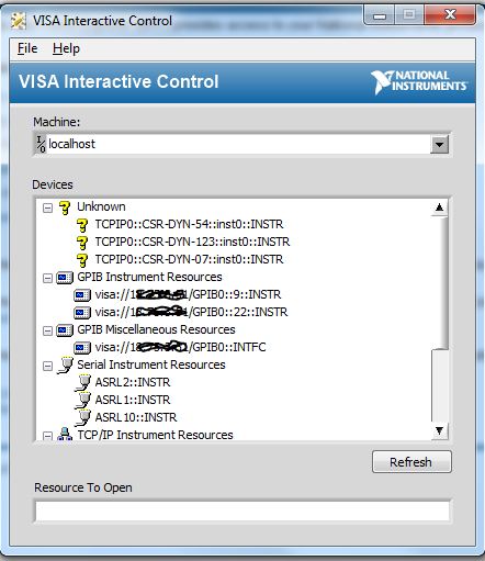

The current VISA Interactive Control layout is a bit differenent from the tutorial.
I do see the instruments now, but they are listed under localhost and I get an error when I try to list them on the remote machine that the GPIB controller is installed in.
I can now access the instruments in my code, but this Localhost versus Remote machine bit is confusing.

In the snippets above, I blacked out the IP address, but all the machines (development, target anf RT) are all on the same subnet.

Hey Rick,
I've done some testing and it seems this is just how GPIB devices appear on Real-Time targets in VISA Interactive Control.  It might seem a little confusing but yes they are supposed appear under local host.  It sounds like aside from the confusion there does not seem to be an actual problem, am I correct?
