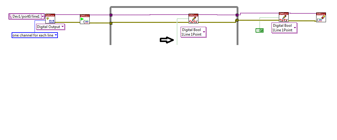

Hi
Thank you very much, finally i have success to read the receive message and compare with preset characters......
However, i still got a small problem.... My received sms is used to trigger ON my DAQ 6009 to turn on(output at digital port=5V), while turn off for next trigger(output at digital port=0V).... I need to turn ON more than one port, but i found that i can only turn ON each port and has to turn it OFF before turn ON another port......
for keep the port ON, the signal of the arrow must be always true, Could I change it to turn ON always for only one pulse trigger(True) and turn OFF for next trigger(True)?
Look forward your reply eagerly.....
Best regard
kelvin
