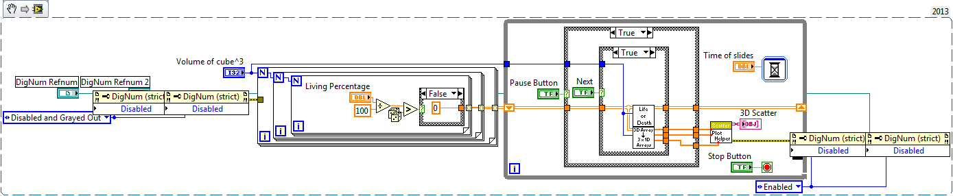

I have made the changes to the button and they work well, but I am unsure how to hide the volume and percentage controls after the program is ran:/
Also, is there anything else you think I should add any features or anything else?
Thanks for all the help!:)
Message 9 of 19
(4,222 Views)
To disable and gray a control/indicator right-click on the control and select Create|Property Node|Disabled.  Drop the Property Node on the block diagram, right-click on the node, and chose Change All to Write.  Now right-click on the property and select Create|Constant.  You can use the same constant for both property nodes.  Make sure you wire the error cluster out of to the structures so you know when the controls are disabled and don't forget to enable the again when the VI stops.
You should also move your delay out of the case structures and just have it in the loop.
You didn't fully understand about comparing doubles.
