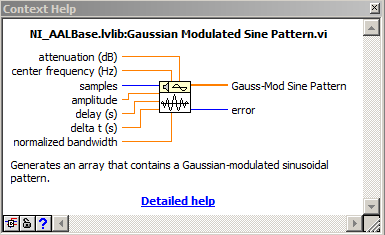

Could someone take a look at my second VI  (Acoustic Sensors2) and determine how to send this Gaussian modulated signal? I'm not sure if I'm using the right function for it.

You are using the right sub-VI to create your Gaussian modulated sine pattern but it is a little more complicated than that.
While the Simulate Signal in your first VI is an Express VI that returned a waveform with embedded sample rate information to be passed to your DAQ generation step, the Gaussian modulated sub-VI returns a simple array of values.
You therefore need to do the following to get this working.
First create controls for the different parameters of the Gaussian sub-VIs and drop these on your front panel. Connect these to the corresponding sub-VI inputs. You then need to enter appropriate values to these controls.
For example:
delta t (s) is the sampling period so the inverse of your sample rate of 2 MS/s. dt = 500 ns.
center frequency (Hz) is the frequency of your tone = 50 kHz
Refer to the help for the other parameters
Once you've done you also need to convert the simple output array to a waveform with sample rate information.The conversion Express VI you are using will not do that for you. Instead simply build a waveform and pass it to your DAQ step.
