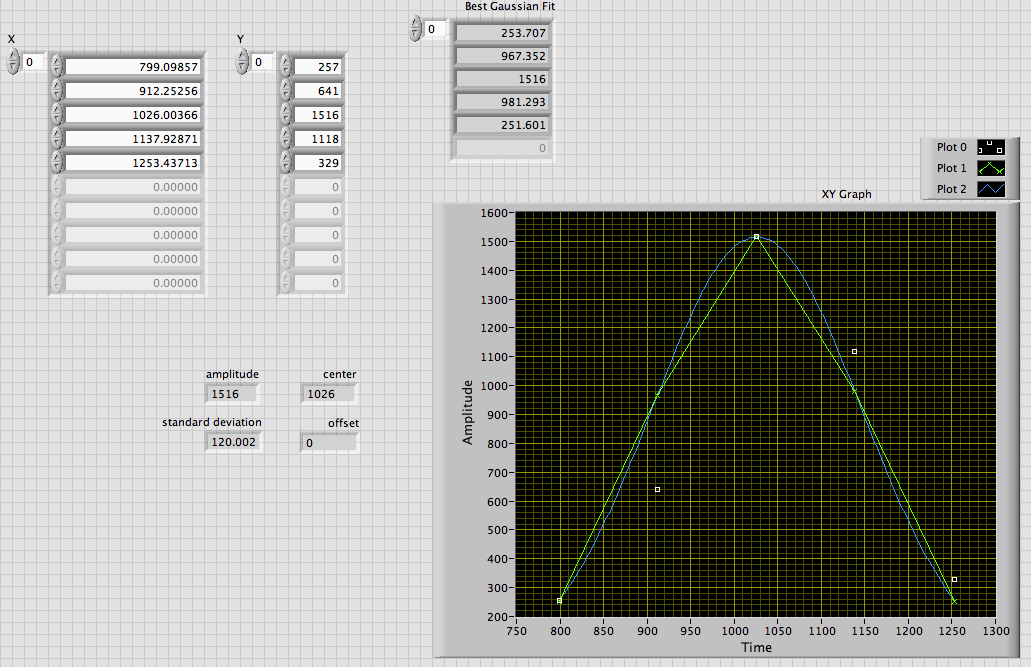

I am developing a program in which I have to fit Gaussian curve on only 4 or 5 data points. When I am using Gaussian Peak Fit or Nonlinear Curve fit, it linearly connects all the points while other fitting software like Origin is fitting Gaussian curve on the same set of data I have attached two images One is from Labview with Gaussian Peak Fit and NonLinear Fit and other is from Origin.

That looks like a plot of the input data.
When I run it with your data I get a Gaussian curve which looks much like your Origin plot.

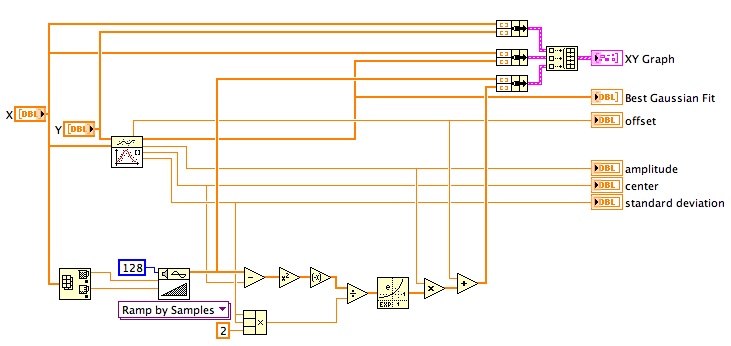

The Plot 2 curve is from 128 points equally spaced along X and Y calculated from the Gaussian formula in the LV help using the output parameters from the fit.  Plot 1 is the Best Gaussian Fit output from the fit VI.  It only has five points.

Basically you are interpolating the data to fit the curve. But there is a different problem Labview Fit always takes maximum Y value as center amplitude but Origin doesn't take it as center it is trying to fit any gaussian that will go through these points.
If you see the images I attached, the center of Labview fit is exactly at maximum Y value, however the center of origin is higher than maximum Y value.And origin's fit look more like a perfect Gaussian fit for the same set of data.

The default values of Initial Guess are all NaN, which causes LV to calculate the guesses.  The default values for Parameter Bounds are +/- Inf except for the offset which are both zero. This, of course, forces the offset output to be zero.  That seems a strange default, but they may have a good reason for it.
Changing the offset bounds to something else results in the output offset being ~215 and the center moves to ~1053.  These match the Origin result to 5 significant figures.
