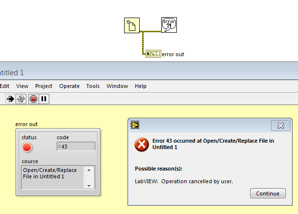

You are correct that they give the same information.  The difference is that if you want to use an error cluster you will need an indicator on your front panel.  If you use the simple error handler you won't have to have an error cluster on your front panel but the user will be notified if an error does occur.
Think about all the programs you normally use (excel, chrome, etc.).  As a user you expect that errors aren't happening, and if errors do occur then the application will usually just close out and you get an error dialog about the error.
Message 3 of 13
