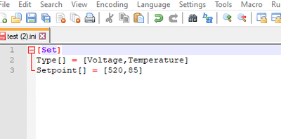

Generate Config ini file trouble with Write key Setpoint[] = [520,85]
I'm trying to create vi to generate ini file. Setpoint will be controlled from vi.

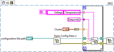

if you want to create ini file that store value from a cluster, you find below an example.
Best Regards.

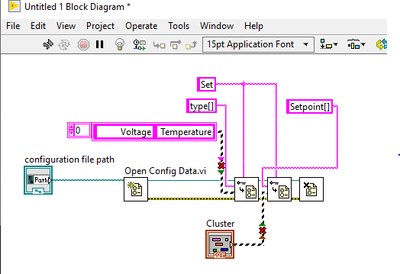

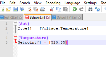

section and key I can do it, but the problem is the values must be in square brackets.
not in separate sections.
Closed I get was:
 Type[] = "[Voltage,Temperature]"
When I was writing a raw string, but the value is always written with quotation marks indicate is a string.
ini file is for TestStand configuration if that helps.
