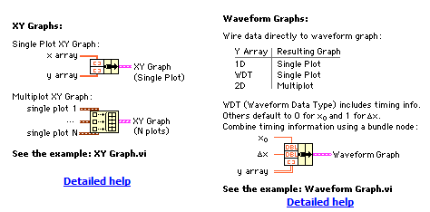

Hi Lynniz,
If you connect 2D array to a Waveform chart then each row will be treated as individual plot.
So what you have to do is, combine data from text files, build 2 D array and use Waveform graph.
P.S. I assume element size in each row will be same, otherwise extra elemnet will be considered as 0.

Thanks for the response Gak.  I forgot to mention that I also have different time segments to graph with each row of the array.  I am currently bundling the time and each row of the array manually to a XY graph.  And to make things more complicated, element size in each row is different.  I just found this out, so I need to find a way around that too.
