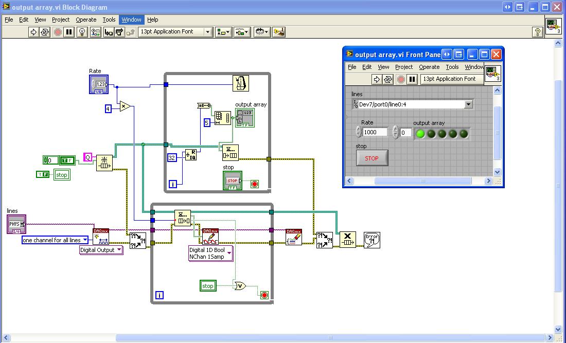

Hi JosephM,
Good afternoon and I hope your well today.
Thanks for your post.
I have attached an example in LabVIEW 8.6. I can re-send it if your not using this version. Firstly it generates a boolean array of 00000 to 11111. Secondly, it then uses a DAQmx Task which is software time (software timed is the only option for USB 6008) to output the need value. To do this, I have used a produce/consumer loop, where the to loop generates the next array, queues this array(size 5) and then the consumer loop will only update the Digital Output when the prodcuer has writen into the queue.
I have tested this, so hopefully it will work for you too. Please let me know if you have any questions, and I'll be happy to help!

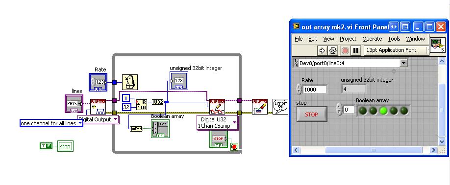

Hi JosephM,
Good afternooon and I hope your well today.
I have just tested the code on a 6008 and also released that the above code is very complex - I was for some reason fixed on using the boolean arrays.
Please see the attached code, in LabVIEW 8.6.
Notice, I have configured the task as one channel for all lines. i.e. so the single numeric I pass, is the value the task should apply to all the channels selected in the input.So if you only select Dev8/port0/line0 for example, the DAQmx driver will look at the LSB of the numeric and work out if line0 should be True of False. It will NOT update any other channels. Thus when I select line0:4 - it will update the first 5 lines (bits) in the numeric. As the code generates a number from 0 - 32, it affective generates 00000 to 11111.
