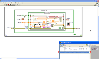

Still don't think it beats text based programming languages but maybe Ill see the light soon...
Figured out that if I dig down into how square wave generation works I could learn a lot. Since it seems as if time is shifted from one iteration to the next (probe window) I need to save the start time somehow if I want to generate a time delimited pulse. I could then set the output value to the selected value as long as the set time hasn't elapsed and to zero after.

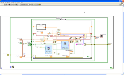

This is the solution I came up with. It's not so pretty but its working. It seems to be eating a lot of CPU power so its not so effective either.
It generates a positive signal for two seconds when switched and then it sends a refresh pulse for as long as the button is switched on. When switched off again it generates another pulse for two seconds.
I haven't understood how you would do the same with DAQmx write but im interrested to learn. Luckily I found this tutor that might guide me (http://zone.ni.com/devzone/cda/tut/p/id/2991). It helps to know what you're looking for. Thanks Dennis!
