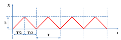

Hi, I want to solve the following problem, but I would like to generate the signal without using predestined blocks. I need 2 parameters that can be modified:
T - signal period; (road sign)
h - signal height; (control)
Te - sampling period; (control)
And as an indication of this the problem is: Consider the signal period to be an integer number of sampling periods T = n x Te. Thus n becomes an input parameter that will have to be read from the graphic interface (control), based on which T is calculated.
I would like a ramp to be generated up to a certain height "h" set by me, and when it reaches that height to go back to 0 with the reverse slope.

  • You know the duration of one signal period: T = n × Te.
  • You know the duration of the rising and falling ramps: T/2 = n/2 × Te.
  • You know the parameter "n" describes the number of samples per signal period.
  • You know there are n/2 samples to ramp up and n/2 samples to ramp down.
  • You know the start and end of each ramp (0, h).
  • You (probably) know the simple linear equation: y = a × x + b.
  • Now all you need to do is to replace "x" by the values from 0 to n/2, a&b by correct values determined by h and n/2 to calculate the ramps…

If you are looking to create a ramp, then use the following:
  • Positive Ramp ==> y = mx + b (where b is the offset set to 0 originally; therefore, y=mx)
  • Negative Ramp ==> y = -mx + h for the negative slope
  • Positive Ramp ==> m = h / (T/2)
  • Negative Ramp ==> -m = -h / (T/2)
Now alternate between the two formulas every half period
