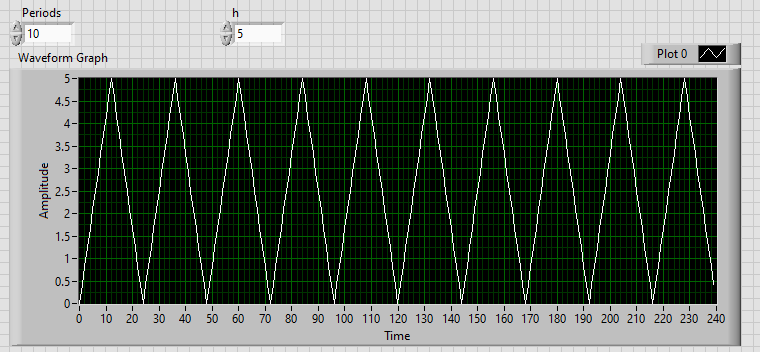

Generate triangular signal with ramp signal.

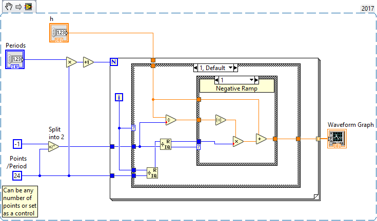

sampling period; (control) is points/period?
What is this block?
Can this block be replaced with something like +, -, x or something else?
In the second if loop, what is in the 2nd position of Positive? Can you give me a screenshot?

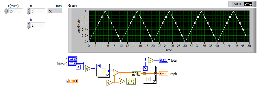

I would probably use significantly less code:
Yes, you need to think about edge effects. For example since the max and zero should not duplicate, you need to decide how to treat things. Tweak as needed.
Note that you must make an effort to understand every subtlety of the code (e.g. the concatenating tunnel and the special mode for "built array", etc.) and be able to explain it to the teacher. The teacher reads this forum too!

mihairusu11@yahoo.com wrote:
What is this block?
The picture is actually a LabVIEW snippet, so just download it and then drop it onto your diagram and all code will be there! (see also here for details)
If you want to terminate the train with the first point, here's how you could modify the code (this is NOT a snippet!)

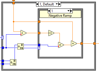

I want the scheme to be as simple as possible, as is the scheme above but without the block with "i" and "rq".That is, it should be with the most fundamental things, more mathematical calculations, based on formulas.
You probably mean "r" and "iq", a simple quotient and remainder function. A fundamental function.
As has been said already, the picture is a snippet, so you can just drop it on the diagram and it will turn into functional code where you can look at the other cases.
